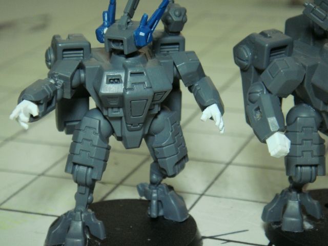

Here are some of the hands I have made:

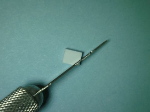

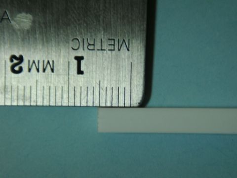

The first step is to take the 4.0mm rod and cut off a 5mm length. This rod isn't too easy to cut with just a hobby knife so you might want to use a hobby saw if you have one.
You should now have a block that looks like this.

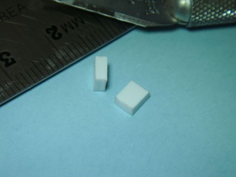

Next cut the block in half the long way so you have to equal pieces.

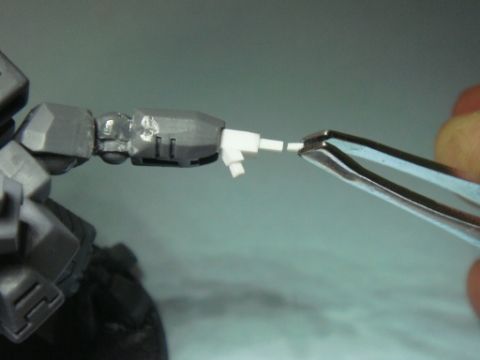

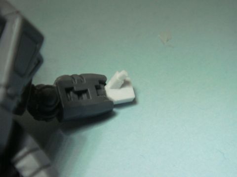

Take one of the pieces and cut off the corners of one of the short sides.

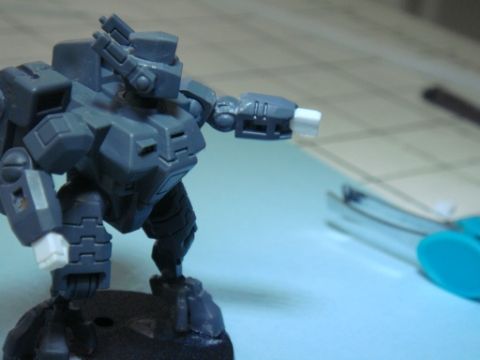

Now use the tweezers to attach the side with the cut corners to the arm of the crisis suit. I use just regular plastic model glue for this part.
Let it sit for a bit so the glue can dry.
