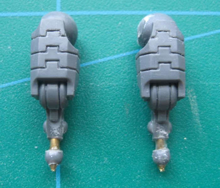

The legs have been lengthened! The joints have been moved 2mm. I think it's enough to make it cooler without making it too obvious. I thought I would show it in this state before finishing it with putty.

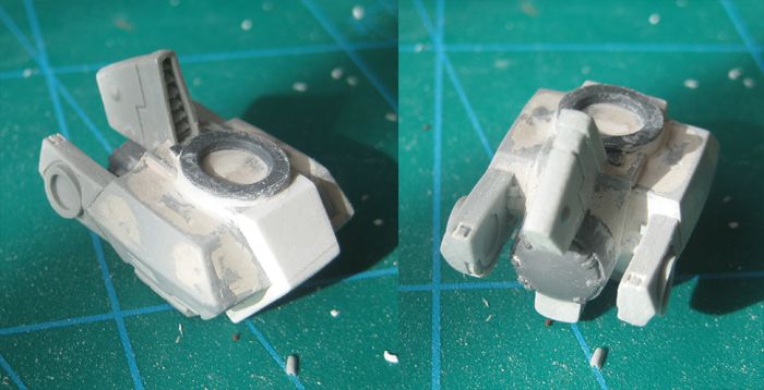

And here it is finally! The finecast commander torso has seen quite a lot of knife and putty. The armor at the front has been buffed, I found the original quite thin. The collar looked quite silly compared to the new suits, so I removed it and replaced it with a wider one. The thruster connectors in the back has been put flush with the rest of the hull, which gives the torso a less boxy look I feel. I also replaced the small energy core in the back with a properly sized one. The energy core is the same size with all other suits I have seen and it makes this slightly bigger suit blend in with the normal sized suits better. Still need to add some strips on it though.
The air intake is slightly angled to one side, so I'll try to fix that with hot water. I also want to add some structure to attach the shoulders to. Originally there was a joint sticking out, but I think it really needs some structure like other suits have. It will add more complexity and it looks more muscular.

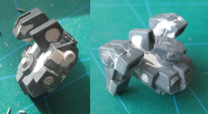

The torso is almost finished now. I buffed up the area around his shoulder joints on the torso, in the spirit of the normal suits. A head of the new crisis suit kit has been used to match the normal suits more and to accentuate the difference of this bigger suit. Also, I found the flat breastplate too plain without details, so I salvaged the Tau symbol from his shoulder plate to fit in it. I wasn't going to use the shoulder plate anyway, so that worked out well. Just now though I realized I still had the original smaller Tau symbol... Oh well, this works out interestingly I guess haha :roll: I also used a thruster from a normal suit to replace the original ones on his lower back, again to buff them up and to get him more in line with the other suits. I forgot to make photo's of his back though, I will do that for next time! The shoulders have been buffed as well, the original shape was too flat for me. I separated the shoulders from the arms so they can be put back slightly inwards, so the shoulders stick outwards more. The arms need to be repositioned as well. The bubbles caused by the molding process still need to be fixed.
The backpack needs some modifications as well. Because the material shrinks when cooling down in the mold most of the surfaces aren't flat. I used a file to fix that, though I have to bring back some details later. I separated the thrusters to align them again later in a less random way. Like my other suits, the backpack will be mounted on the torso slightly higher than originally intended.
