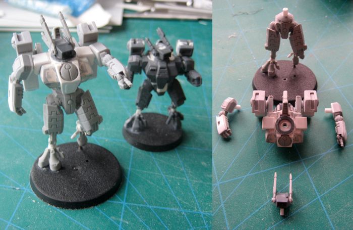

So here it is! I actually finished the suit a while back, but for the detail on the hip joints. Too lazy to go to the store to buy the plastic rod to make it :crafty: In the end I changed the knee as well.
There was one suit I didn't cut to pieces by chance. I'm glad I didn't start work on it yet, it's cool seeing them side by side showing the difference.
So I guess that concludes my quest to make old suits look cool! I hope I kept the original look (and made them cool enough :P ). Progress was going so fast in the end that I forgot to make photos. I guess to make up for that I can make detail photos when desired. And of course if anyone has questions I will answer as best I can.
As a final note, I started working on other suits as well and I find already assembled suits easier to convert to this style, so it's perfect for upgrading existing armies!

I would LOVE a step by step or any sort of insight on how to accomplish this. I've been wanting to do something similar to a few of my crisis suits very soon and have been trying to find what materials and methods to use

Very crisp result, definitely looking forward to the new models you speak of. Very helpful to those wanting to update their current XV8s :)

Thank you Tarnag and Tael!
Most of my other suits will be converted in some way or another, but the core look will be the same as this one. I should be able to explain some things better with them. The most important part of this conversion is making the right cuts and tidying up the mess, like smoothing surfaces and filling gaps. So most of that is covered in the previous updates, but I will try to add to that. If there are any specific questions I can keep them in mind for next updates.
